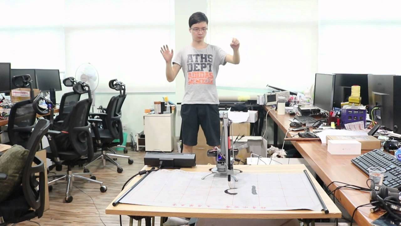

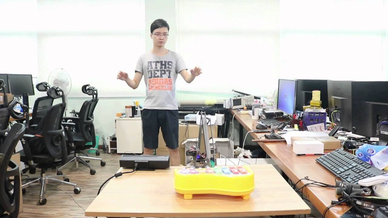

Hi, makers, we developed a simple program which can use Kinect for Windows to control uArm through Visual Studio.
There are three main functions that the program can do:
1, 3D coordinates Control
2, Play piano
3, Calligraphy
and the videos below show final results of these functions:
The main method to control uArm through Kinect is by acquiring left-hand-coordinate and transferring this data to uArm to execute certain function.
