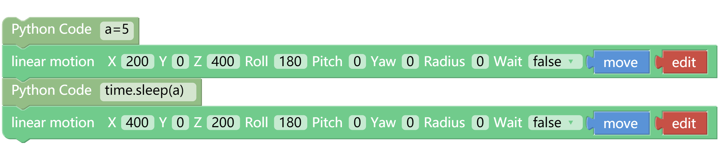

Here is a example how to use Python variable wait in Blockly project for the moment.
#pure python wait is like
import time
a=5
time.sleep(5)
In Blockly, you need use the Block-Python code like the image, and import time is no need.
Thank you, that works great.

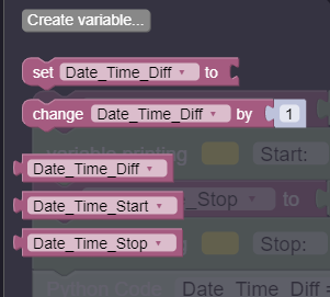

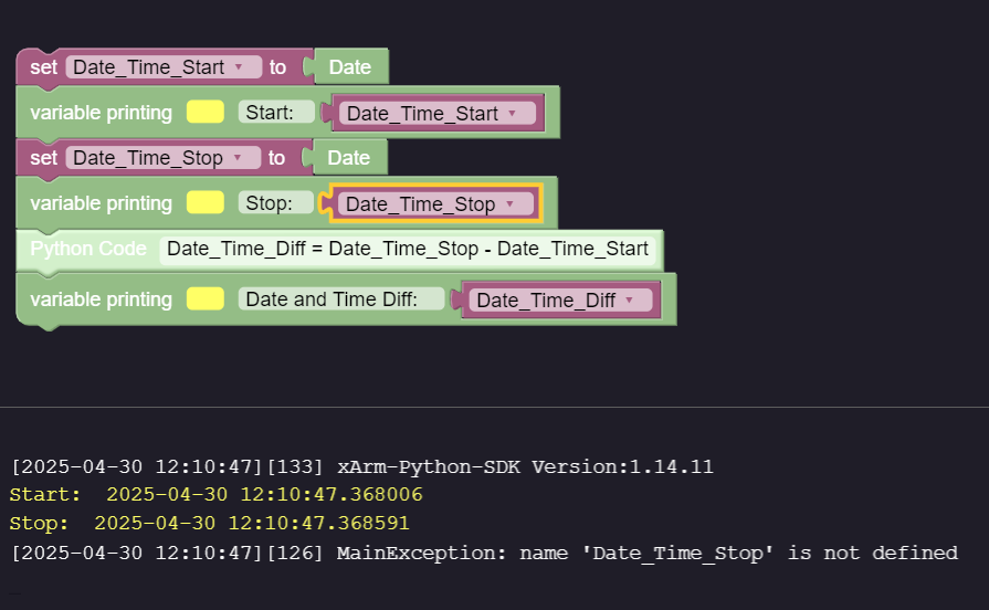

Second question, why this error message?
Date_Time_Start, Date_Time_Stop and Date_Time_Diff are all defined
Blocky Variables defined - Capture

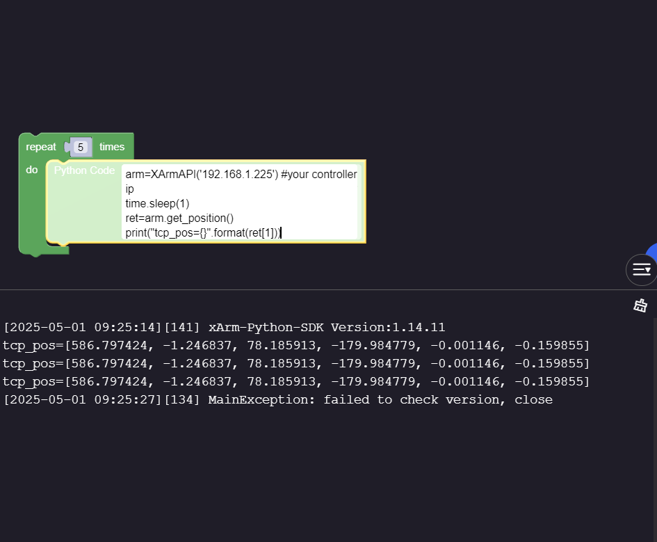

Trying to Test running Python code and after several loops I get an error:

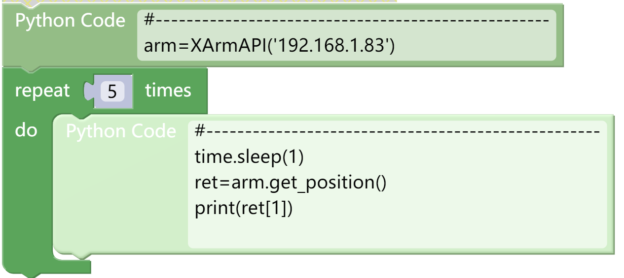

Every time you use arm=XArmAPI('192.168.1.83'), it will set up a TCP connection, so put it outside the loop
like that

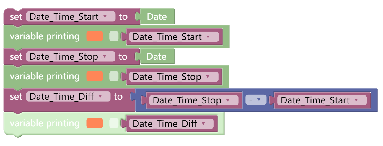

The python codes does not accept the variable created by the Blockly. You can use the Blockly math Block to calculate the time difference, like that

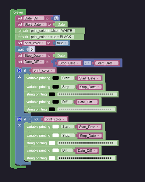

In Blocky, when using “variable printing” and “string printing”, a color must be chosen. When in REAL mode the screen is White and in SIM mode it is Black.
How can I set the color using a variable?
Example: set color_variable = 0 for black and 1 for white.
then have the python code set the color of “variable printing” and “string printing” to the correct color.
is this possible?
This is the only way I could accomplish the setting of print colors:
Yes, that’s a problem. As of now you could use a color shows both on white and black background, like red or green.
