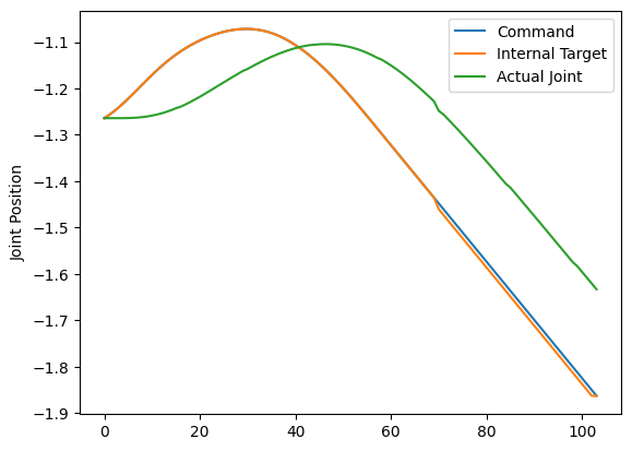

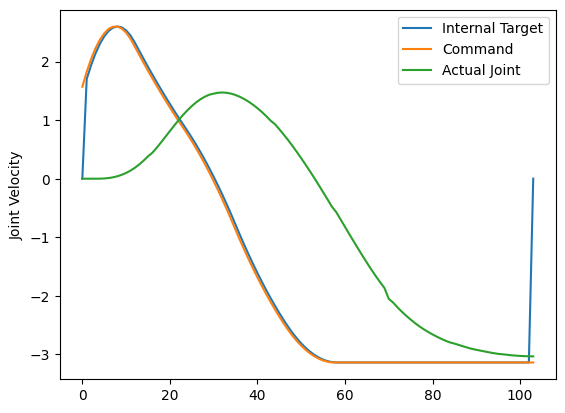

I am trying to do highly dynamic fast motions with the xarm such as the following:https://drive.google.com/file/d/1Jou50vZmpWxzOxUY7cLLy3pBItvSXYDB/view?usp=sharing. But am noticing a significant tracking error with the trajectory I’m sending to the robot:

If I’m able to specify a desired velocity and a feedforward torque I would be better able to control the arm, let me know if there is anyway for this capability. Thanks!

Thanks for the info Krishna, now we understand the issue.
We are trying to modify the PID to reduce the servo motor delay, will let you know the result soon.
