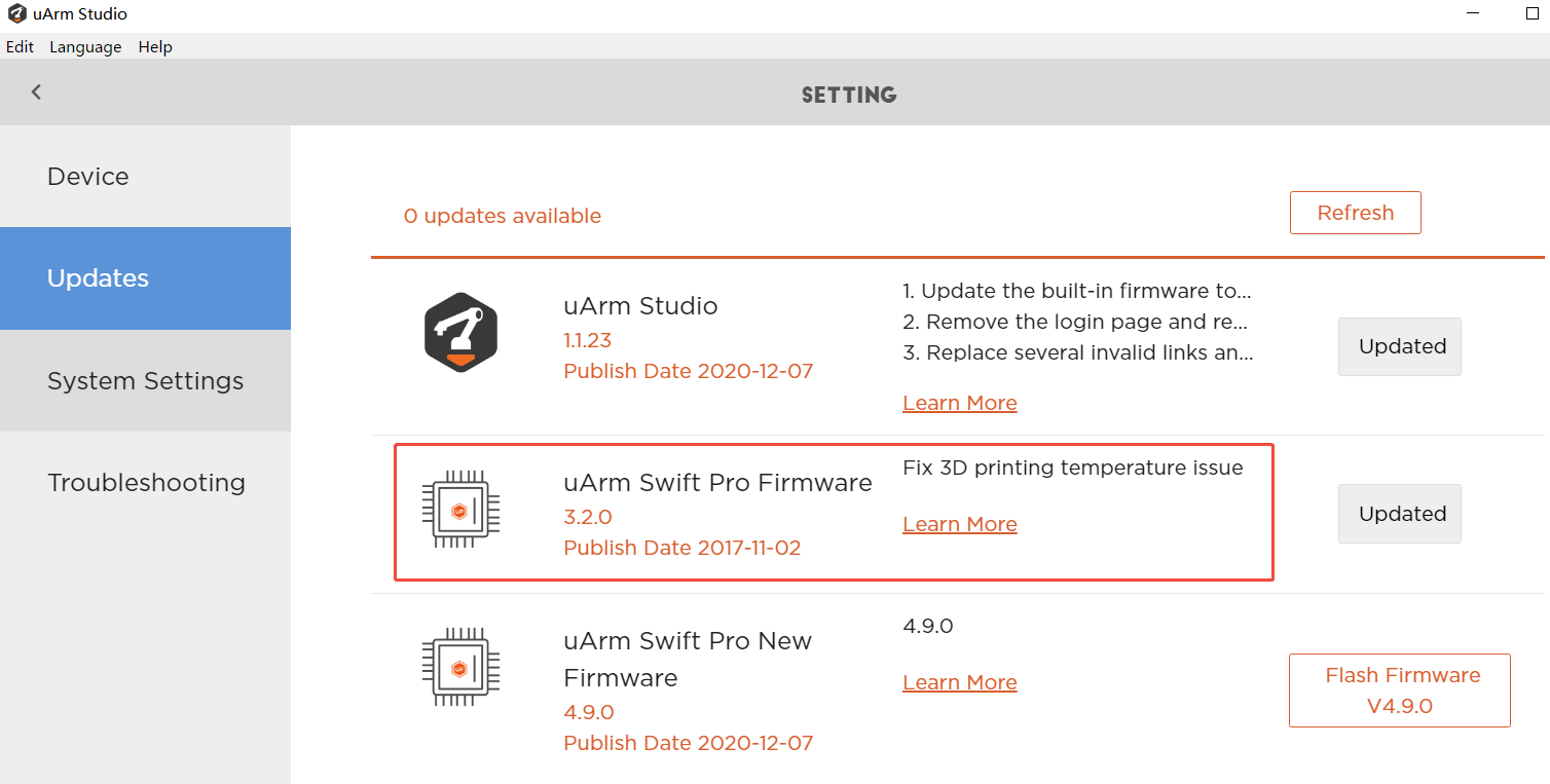

Hi Sws,
The uArm on your hand is the latest version; it is connected via a serial port, not an IP.
Please download the uArm Studio from the official website.
Download Center | UFACTORY
For offline learning mode, you need to flash the firmware to V3.x|
Best regards,
Minna
