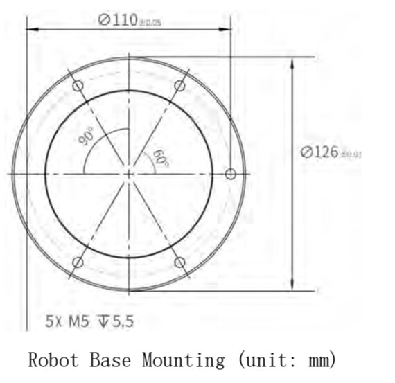

Is the xarm base mounting pattern similar to any other brands to reuse pedestals?
Referring to this figure below about the 5 holes for mounting. Is this similar a bolt pattern to any other brand, to make finding pre-drilled mounting plates easier? Is it compatible with any of these stock mounting plates from 8020 as here:

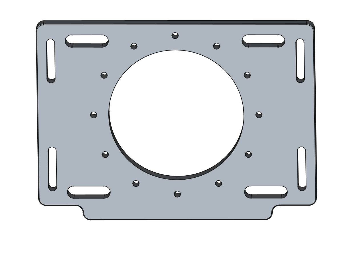

Also, consider that even with your included mounting plate, I had to modify the mounting plate to accommodate 1-inch offset optical tables, which are common used for robotics applications, and 1 inch offsets are useful for use with 8020 1 inch profiles that are common in the US.

Hi,
As far as I know, the xArm’s mounting is not same to other brand.
The xArm come with a mounting plate, is that useful in your project?
Here is the link to download the 3d file of the xArm mounting plate
https://www.ufactory.cc/wp-content/uploads/2024/02/xArm-Mounting-Tool.zip
