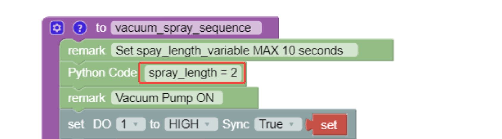

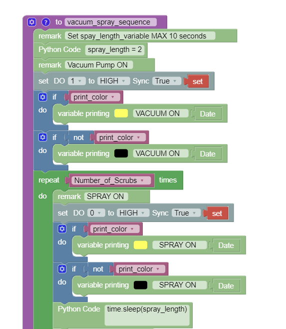

Vacuum_Spray_Sequence - Capture
I want to move the “Python Code spray_length = 2” command to a different function.

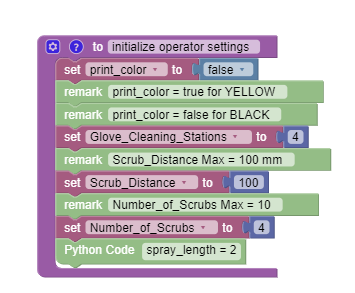

Initialize_operator_settings - Capture

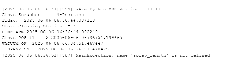

When I move it I then I get the following error:
spray_length_undefined ERROR - Capture
I want to define a VARIABLE in the “initialize operator settings” FUNCTION and have it passed to the “vacuum_spray_sequence” FUNCTION,

Here is how I was able to define a variable in one function and pass it to another without any errors.
spray_length = 1

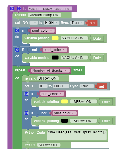

and used in another funcrtion that calls the variable using Python Code:
by using time.sleep(self_vars[‘spray_length’])
Cool, that’s a better way.
