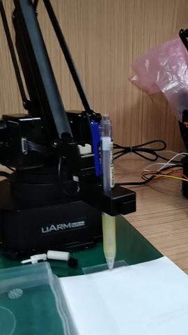

Sorry for the unclear statements.
I used the universal holder to hold a pen and ask the arm to slightly touch paper.
Then a dot will exist on the paper.
Then I turn off the arm and wait for about 5 minutes and ask the arm to do the same thing.
There were two dots on the paper and the distance is about 2 mm.
It is not accumulating, I didn’t see any bigger deviations even longer time.

This week I kept trying to reproduce it but the deviation is not as big as before these days. :sweat_smile:
Here I upload the video to show how I did this.
A universal holder is used to hold a pen.
The arm is programmed to draw 3 dots on the paper.
After 5 times I turn off the arm then turn on after about 10 minutes.
The dots overlapped and became a bigger dot whose diameter is about 1mm.
OK. You’d better fix the paper and the uArm.
