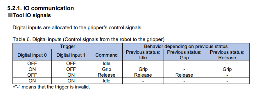

Another possibility would be this tool :
Electric Vacuum Gripper for Collaborative Robots – ZXPE5 from SMC
Do you think it would work ?
Here is a manual of it and I think page 20 it speaks about the communication.
Best regards,
Jules
Hi Jules,
The control method is not indicated in the MG10 documentation. You need to contact OnRobot for confirmation.
Regarding ZXPE5 from SMC, it is controlled by IO and should be able to be integrated into our arm, but we haven’t tried it.
