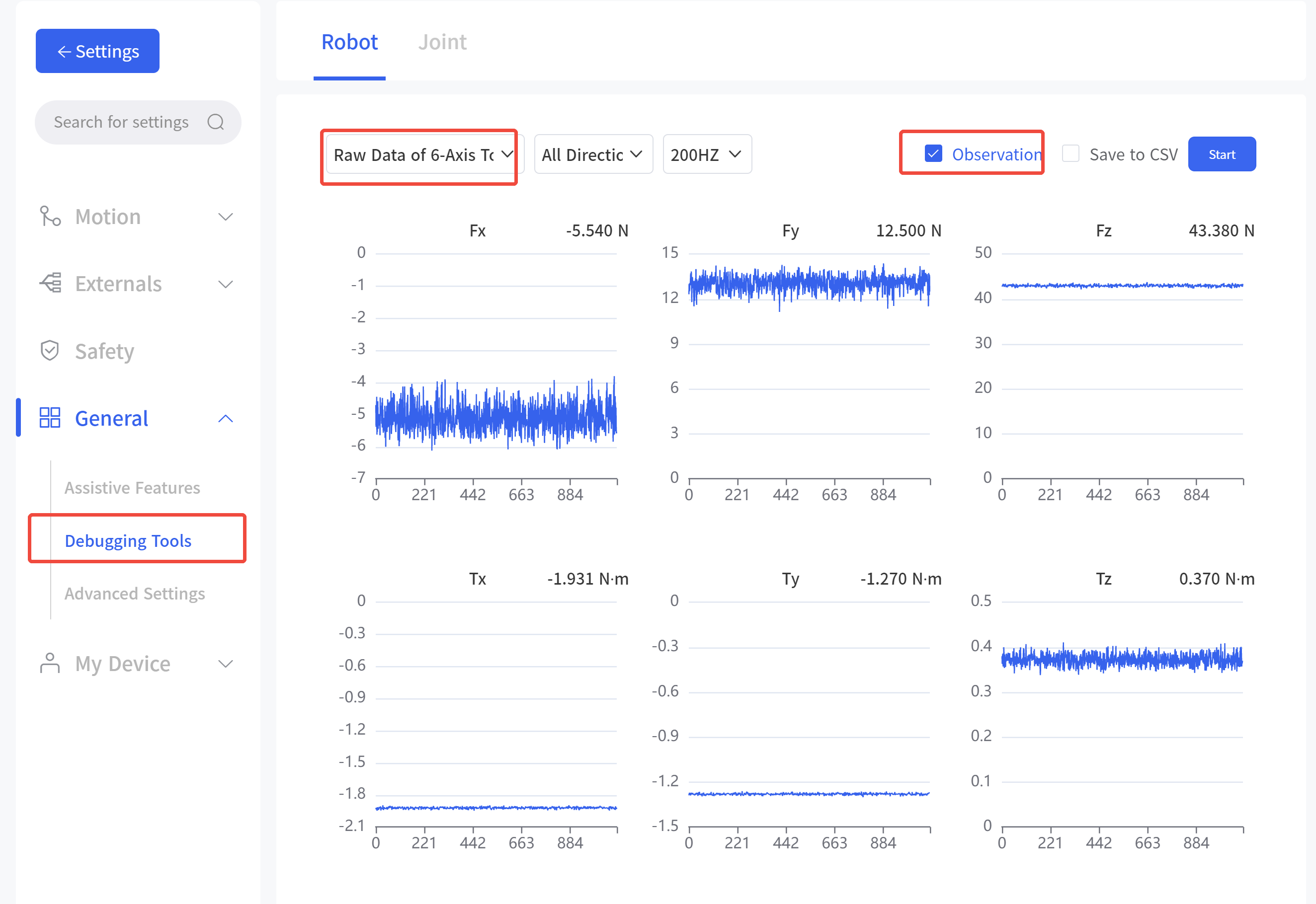

Force/Torque Sensor Diagnostic Instructions
1. Check if the sensor is functioning properly
  1. Remove the tool/gripper from the sensor.
  2. Move the robot to the home (zero) position.
  3. Open UFACTORY Studio:
    Settings > General > Debugging Tools
  4. Set the following:
    • Mode: Raw Data of 6-Axis Torque Sensor
    • Direction: All
    • Frequency: 200Hz
    • Check Observation
  5. Click Start and observe data for about 10 seconds.
Expected ranges (no load):
  • Force: Fx, Fy, Fz should be within ±60 N
  • Torque: Tx, Ty, Tz should be within ±2 N·m

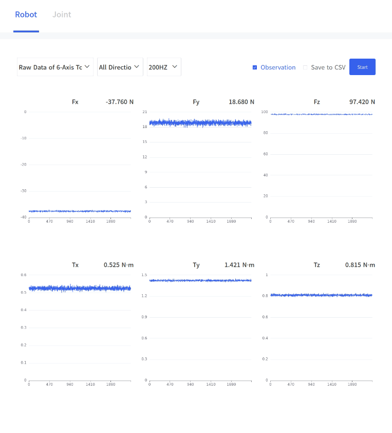

  1. I’ve removed the gripper and and reset the arm to home position, the Fz seems to be quite off (97N) but the other values are fine and there doesn’t seem to be much variation in the observation:
  1. The equivalent mass (M) is set to 0.06 in my script and J is set to 0.01 * M
(note that currently, I’m only running impedance on the x,y,z axis and not Rx, Ry, Rz)
Thanks for the clarification.
Although the force-torque sensor readings are already out of the factory threshold, it can still be used. You can send it back for inspection and repair when convenient.
In the meantime, try increasing the equivalent mass parameter—e.g., set it to 0.08 kg or higher—and see if it improves the impedance behavior.
