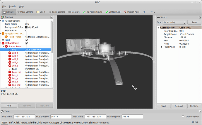

I have some more troubleshooting questions about Rviz and UArmForROS if you don’t mind.
I’ve reinstalled ROS and uArmForROS on a laptop running ROS Indigo on Xubuntu 14.04. I’m having some trouble with the display and control nodes of uArmForROS.
The display node works and when I physically move the robot the robot also moves. However this is inconsistent and sometimes the uArm Robot model doesn’t open correctly in Rviz. This happens maybe 50% of the time, I’ll post the screen shot below. The arms base link appears to be magnitudes larger than the other links of the arm. See below in the next forum post.
With regards to the control node, a similar problem appears - I’ve never had the control aspect working. I’ll post the screen grab below. Do you have any suggestions on how to fix?
Thanks for all your help!
Display error screen grab:

So it seems that display mode will work if I try and run it without doing anything else in RVIZ. For example, start laptop > start roscore, start, connect uArm in listenmode > start display node > Rviz with display works.
But if I then close Rviz and try and run it a second time, it will not work unless I restart my system. The same happens if I try and use Control mode first.
The main problem seems that the base link is always too large, the rest of the uArm will move when I move the robot with my hands but there is a degree of error. For example if I do not tough the robot, the model in Rviz vibrates slightly, or moves back and forth very quickly.

Hi Caspa,
I have tested the code you on my computer, the result is: It works fine. So I will tell you how did I test it.
Firstly, the code you send to me (the RVIZ part) is 100% same to my code.
For testing, I removed all the libraries I wrote before and put your code in the directory /catkin_ws. And then use catkin_make to install your library.

Type roslaunch to launch the display mode first – DO NOT RUN display mode and control mode in the same time
roslaunch uarm display.launch
STEP 4: Then open another (Forth) terminal, run rviz
rosrun rviz rviz
STEP 5: Then, in rviz,
Add -> RobotModel
set Fixed Frame -> base
That you can use display mode.
