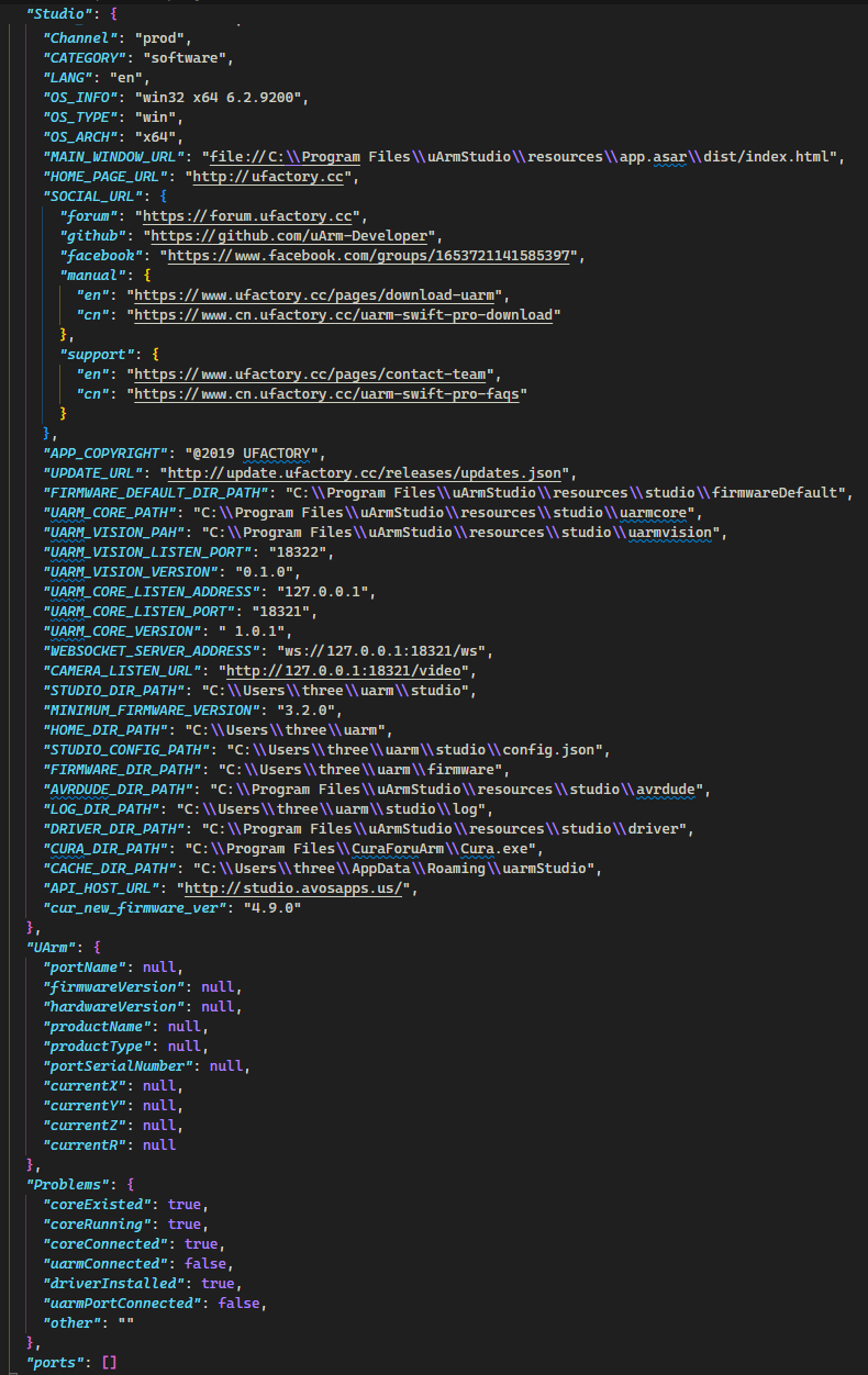

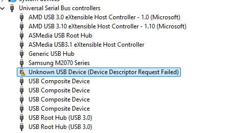

I also have similar problems. A several days ago it worked. But today it doesn’t. I guess, after some several updates of windows, this problem occurred. Can you support this? I know this arm is too old to get proper supports. But…

Hi Jaeyoon,
Please download driver4.zip from the Google link, and refer to the docs to install the driver for uArm manually.
uarm-xloader - Google ドライブ
If there is still a problem, try it on another PC and let me know the result. Thanks.
