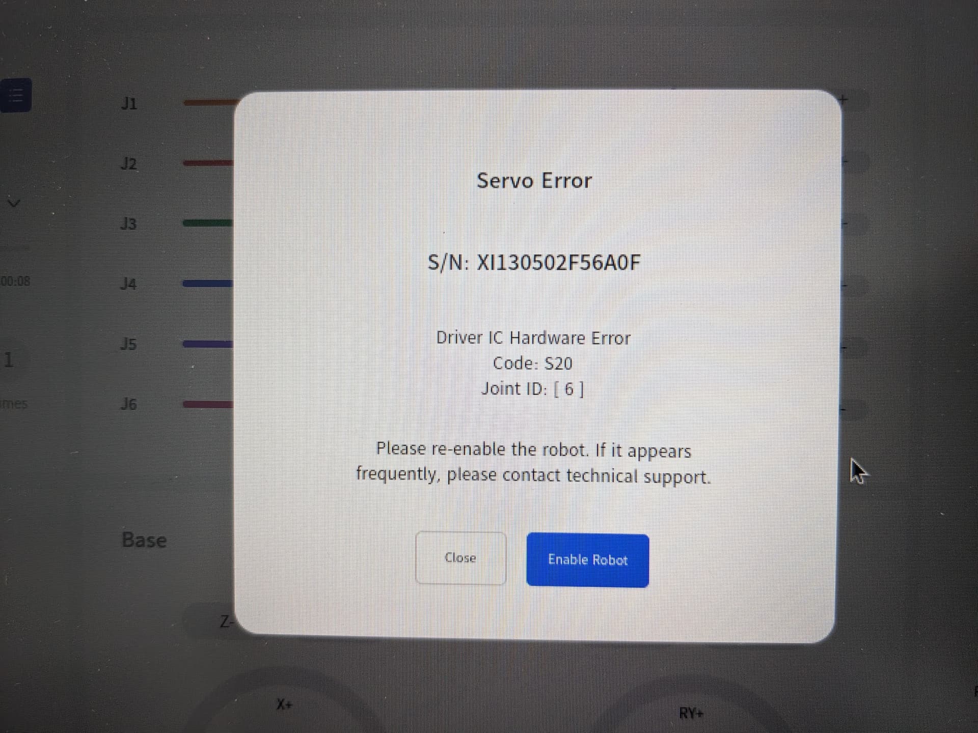

Hello, we have a xArm6, which keeps show the S20 error.
I saw a previous post with the same S20 error, and went through a similar process, but the error did not go away: Error code S20 - Driver IC Hardware Error

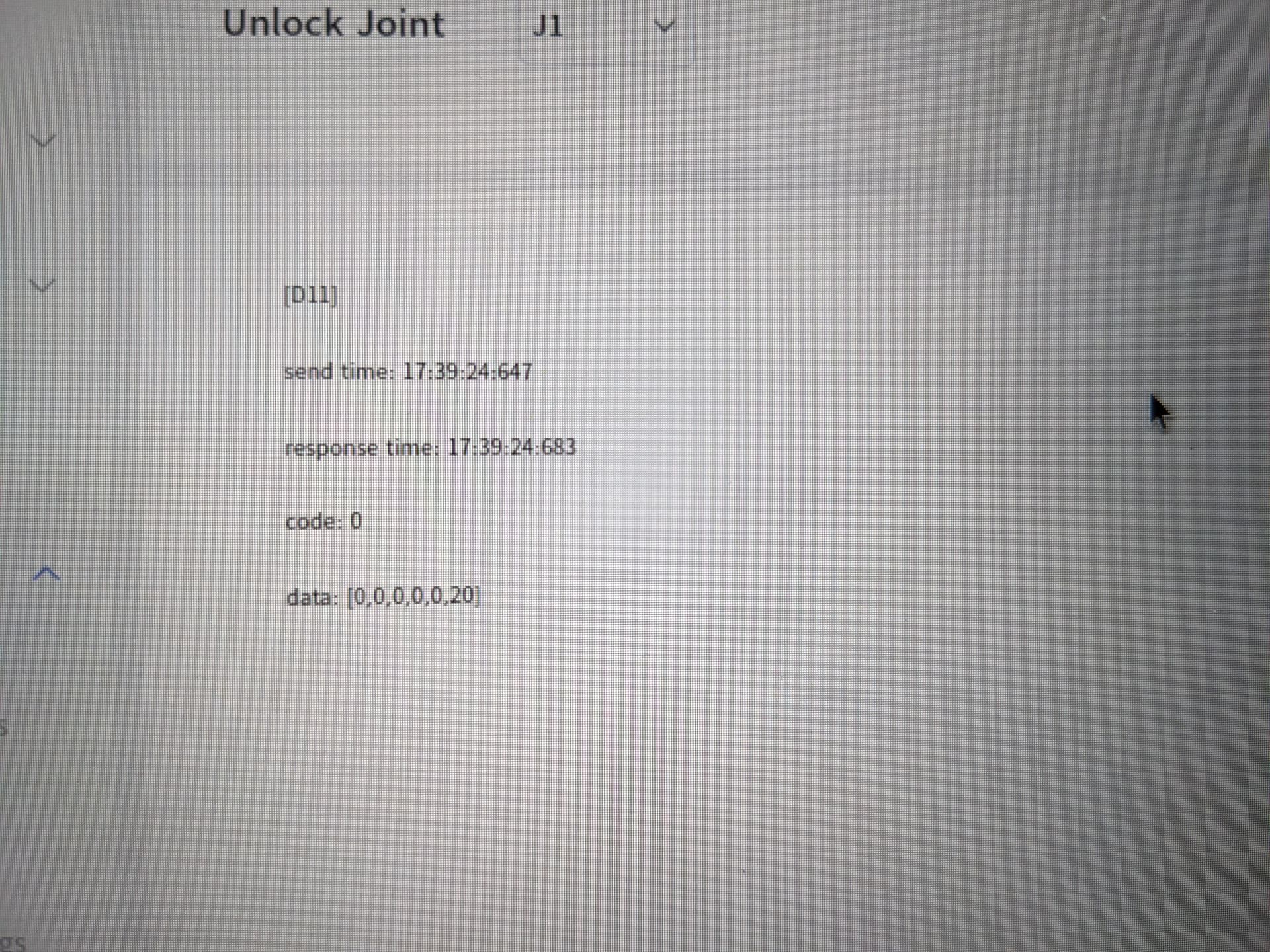

Here is the D11 debugging message:

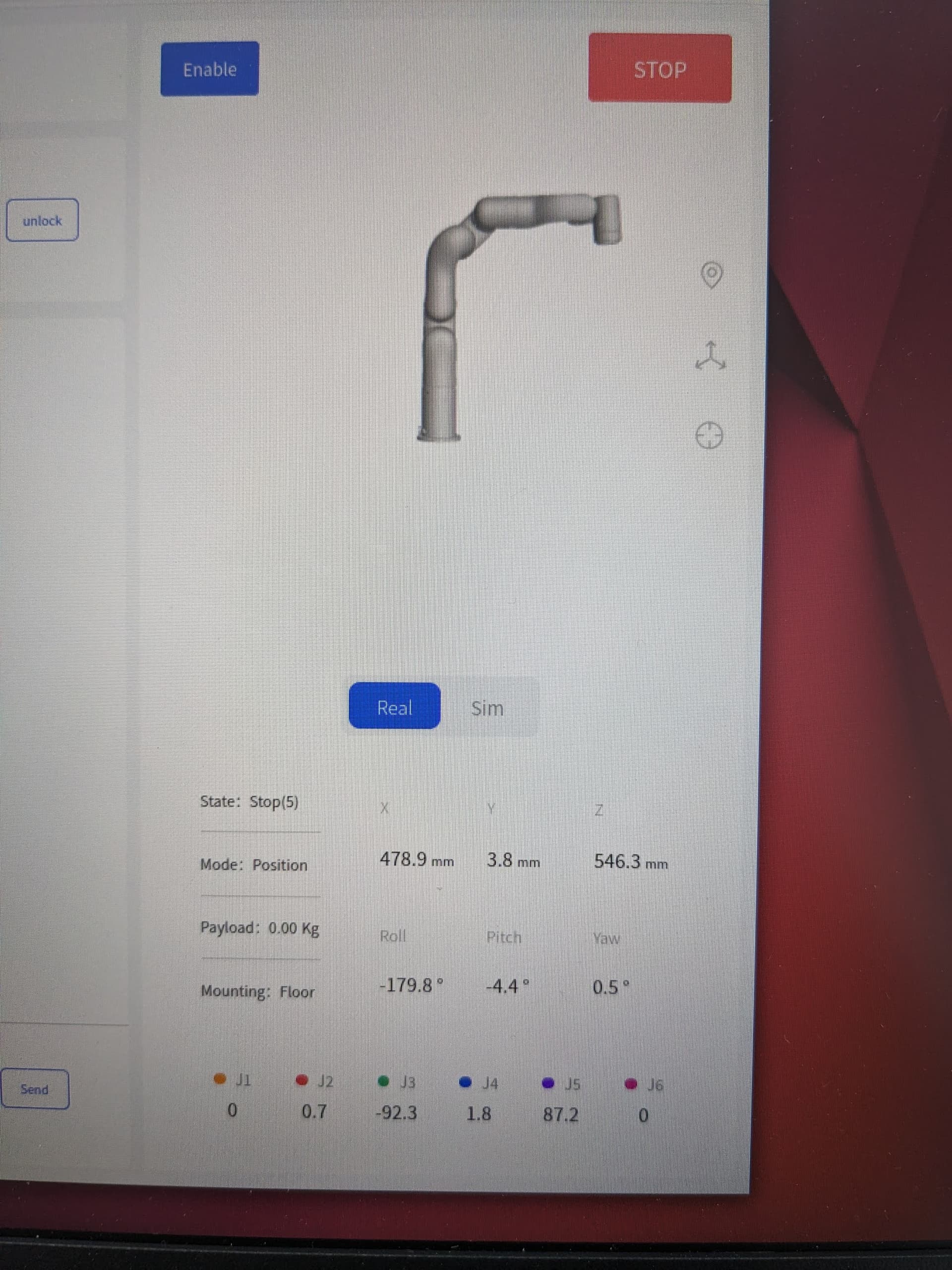

Here is the arm’s current pose:

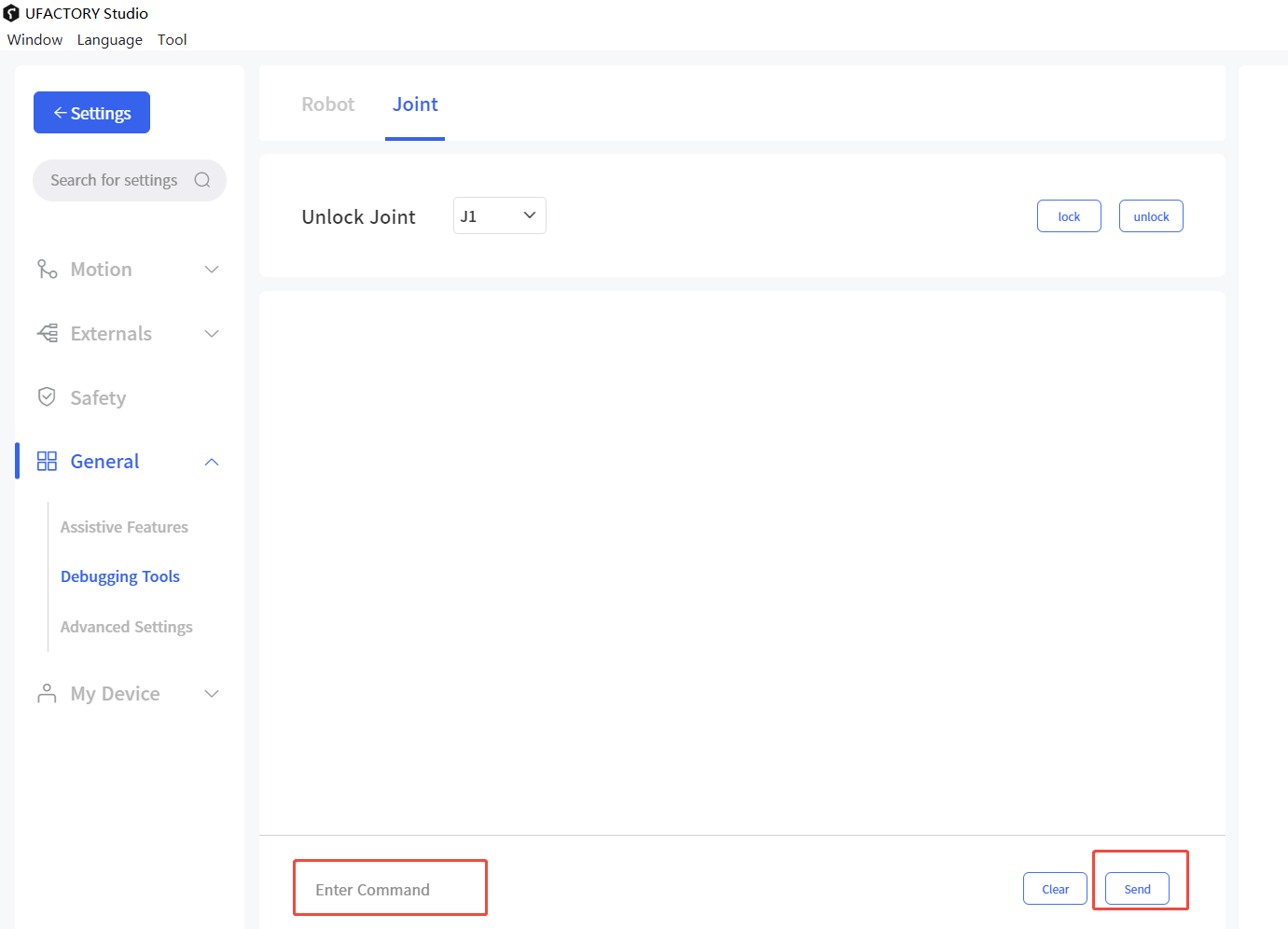

Hi Kyoung,

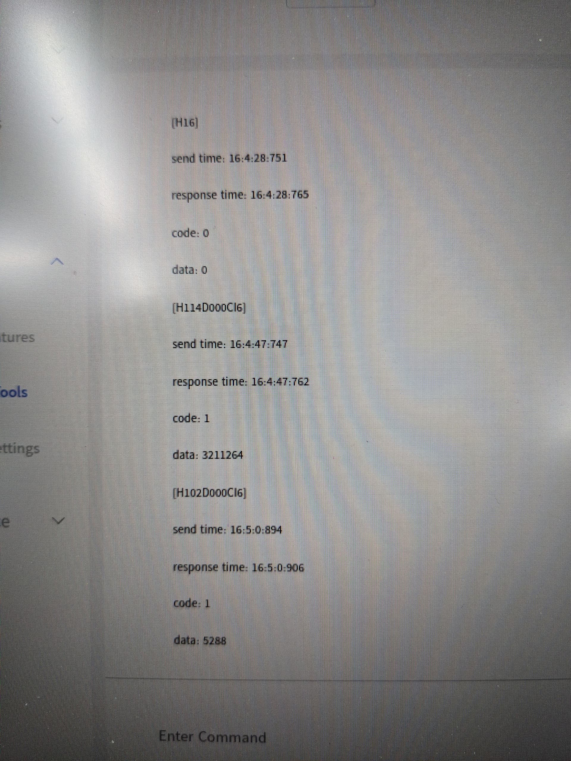

Please enter ‘Settings-General-Debugging Tools-Joint’, send the command below and take a screenshot of the result to us, thanks in advance.
And How did the S20 error happen?
  1. H16
  2. H114D000CI6
  3. H102D000CI6

Hi Minna, here is the screen shot with the results.
The S20 error occurred when I put the robot in manual mode and moved the arm a bit, but the joints got locked. To unlock them, I entered UFactory Studio, and that’s when the error started appearing. Since then, the S20 error hasn’t disappeared, and I haven’t been able to operate the robot.

Hi Kyoung,
Thanks for the screenshot, it’s most likely a hardware issue.
Please reach to support@ufactory.cc and share the contact information,we will proceed to get the arm back for repair, thank you.
